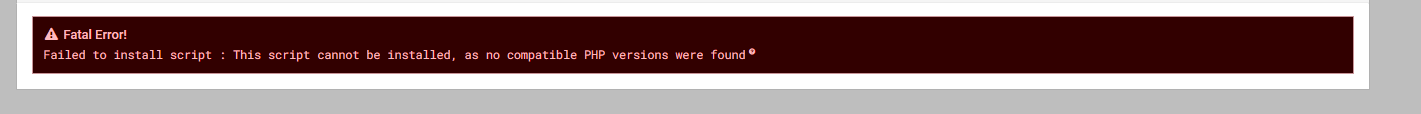

hello everyone I try to install roundcube but I have this error :
I installed the PHP and here the php -v :
PHP 7.4.3-4ubuntu2.19 (cli) (built: Jun 27 2023 15:49:59) ( NTS )
Copyright (c) The PHP Group
Zend Engine v3.4.0, Copyright (c) Zend Technologies
with Zend OPcache v7.4.3-4ubuntu2.19, Copyright (c), by Zend Technologies
What I should do please
You should go to PHP Options page and make sure that PHP is enabled for this particular virtual server (domain).
hi thank you for quick response I should select the second one ?
It doesn’t look right. You said you have made a clean install? You should have PHP-FPM mode available.
Which OS and version have you installed Virtualmin on?
You continue to not have a functional Virtualmin system.
Stop wasting your time and ours with an installation that’s a mess. You didn’t follow instructions for installing Virtualmin, so you don’t have a complete installation. I don’t know what you did wrong, but none of this happens on a complete installation you’d get by following our installation instructions.
https://www.virtualmin.com/download/

It’s obviously not working. You don’t have PHP-FPM execution mode available. Did you do the Configuration Check? That comes after the setup wizard.
We need to see the output of that, I guess. Something is quite wrong with your system.
Go to System Settings->Re-check Configuration and show us what it prints out.
here is it
That’s not a complete installation. You’re missing tons of stuff.
There must have been errors when you installed. You need to start with a fresh OS installation, run the install script, and make sure it completes without error. The installation will show you what steps it has completed as it goes; it shows each of the stages and how they’re progressing. All the steps need to complete. If they don’t, whatever is going wrong needs to be solved.
