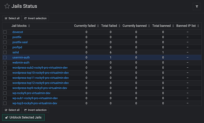

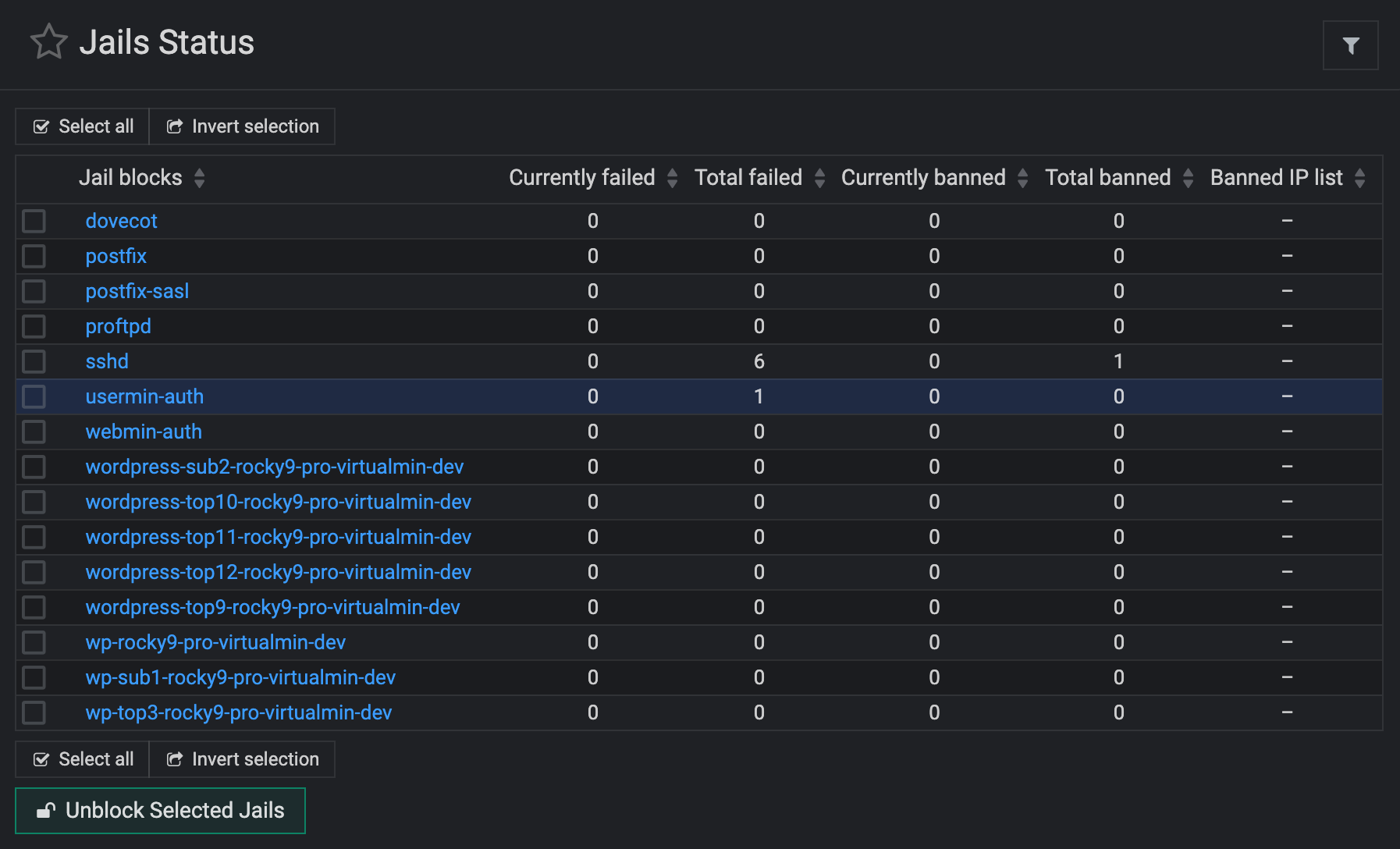

The Usermin jail should appear in the Jail Status list, for example:

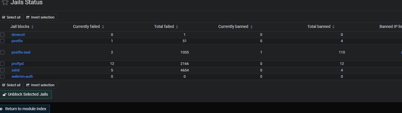

I followed the instructions you posted but it does not show in Jail Status
Debain 11

I tried some failed logins and it shows in Jail Status :+1:
