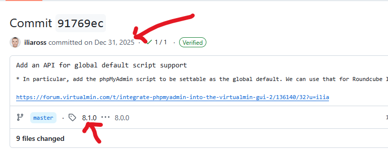

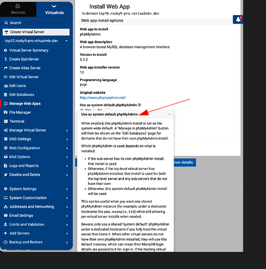

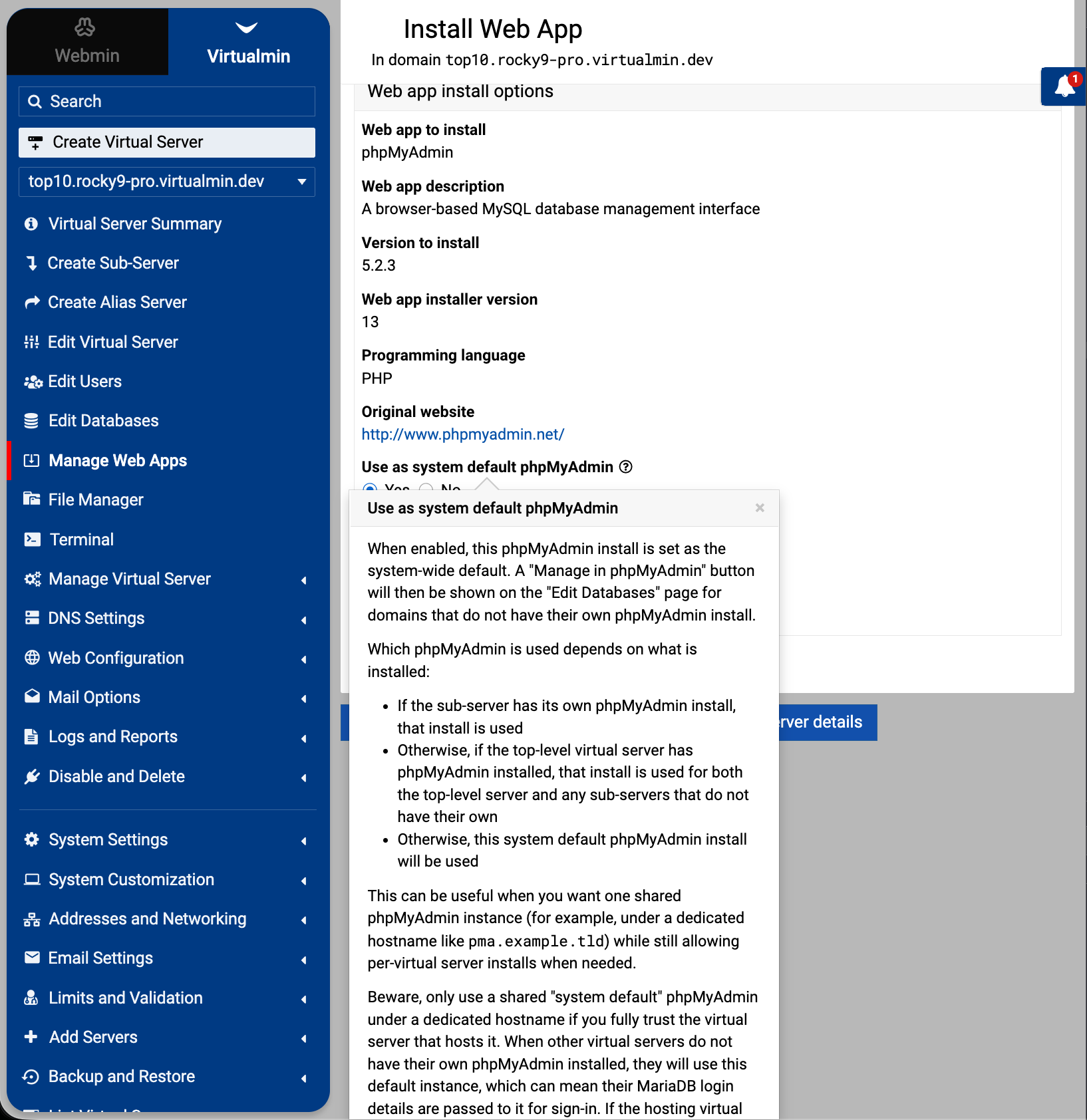

I don’t think anyone does from the install screen I see this

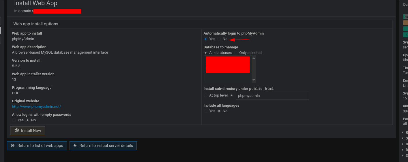

the only thing I see is the auto login option & no option to globalise the app. can you supply a link to where you saw this feature being implemented
Most likely not been released yet as the option shown in the screen shot is not present,
try a dev build of virtualmin on a vm somewhere and see if the option is there
I think it is added, the back of my head says that something needs to be done on pre-existing systems to get this option to show.
This might be useless info, but before clicking go on a selected web installer, try the show install options button.

  • I do not have this option.
  • I have checked the code is present on my dev system and it is up to date.
  • Maybe this is a bug, permission, or setting that needs to be turned on.
  • or there is a patch, but the ones I have seen address http_auth and not the setting being missing.
I am at a loss
Reading through the tooltip on the screenshot you supplied it looks like it needs to be enabled, perhaps there is a setting in the script installer module settings as suggested by @WNYmathGuy. Personally I don’t use the script installer to install phpmyadmin as it is in the repository which means I get the version that the version of my os recommends rather than a version that may need a different version of php which I might not have installed

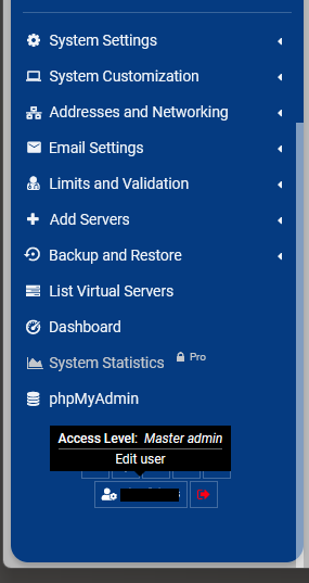

You need to be logged in as a master administrator to see that option. Are you?
Yes, I only ever log in with that at the minute.
Can you provide the full screenshot of the page, including the navigation menu and the user account used?

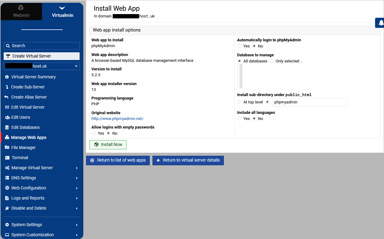

  • I don’t know if this has any relevance, this is my dev server and this is the server with the full list off apps but is GPL.
  • I have just updated to Webmin 2.650 this morning.
  • Is this a script caching issue?
  • I could not get the full menu in the image because it is scrollable.

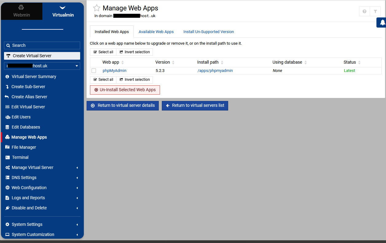

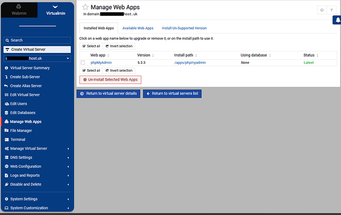

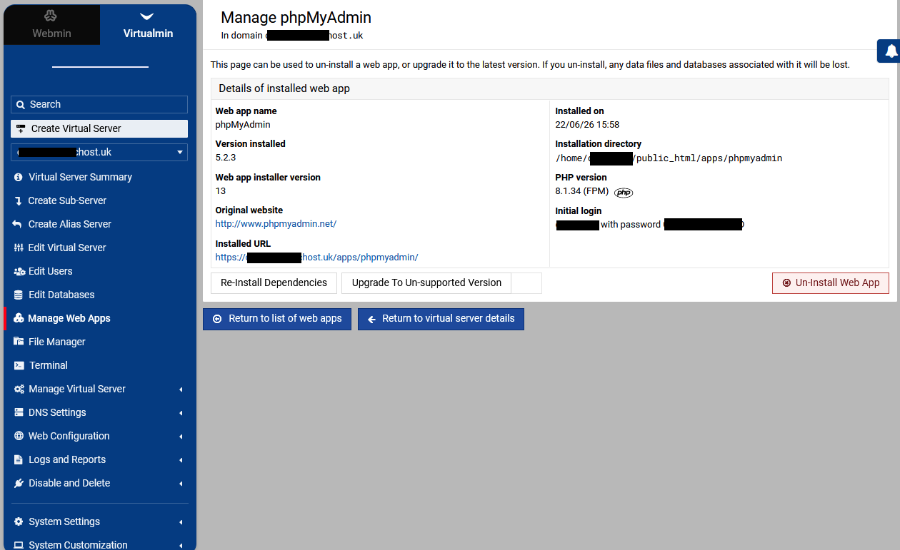

So I made some images of my currently installed phpMyAdmin Web app
Proof that I have logged in using the master admin
I uninstalled phpMyadmin Web app so I could show the install page with no global option
Is this what you need, I can do more if these are the wrong ones.
thanks
I don’t see global either, not that I need it :slight_smile:
