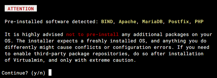

We’ve got this message when we run the script for the upgrade to Pro
What command(s) are you running?

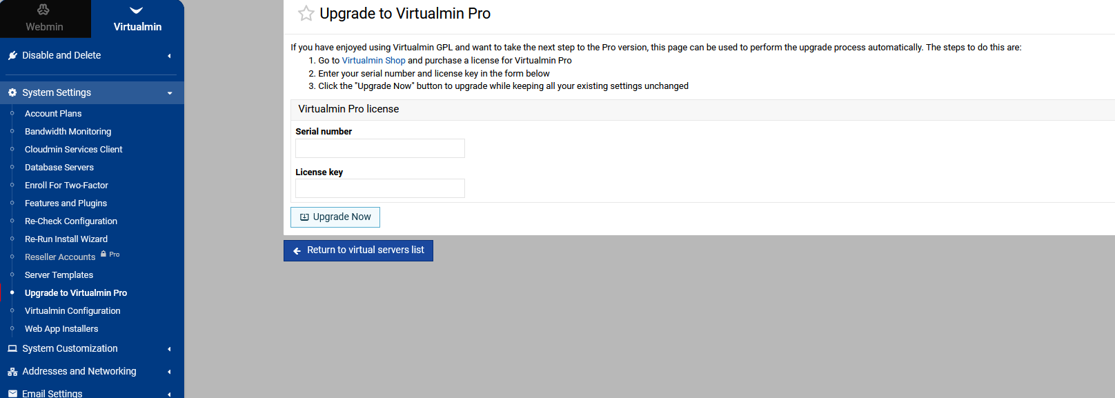

Should be able to log in to Virtualmin and under system setting there is a menu to upgrade to pro by entering license information. Or if you want to do this from CLI : https://www.virtualmin.com/docs/development/api-programs/upgrade-license/
You do NOT do that, you just add the key to your current running system.
As the documentation says, you do not run the install script to upgrade:
“Never run the virtualmin-install.sh script to upgrade or renew or to try to repair an existing Virtualmin system! The virtualmin change-license command is used for license changes and renewals. Check the license FAQ for details.”
The install script is for installing. It is not for upgrading.
