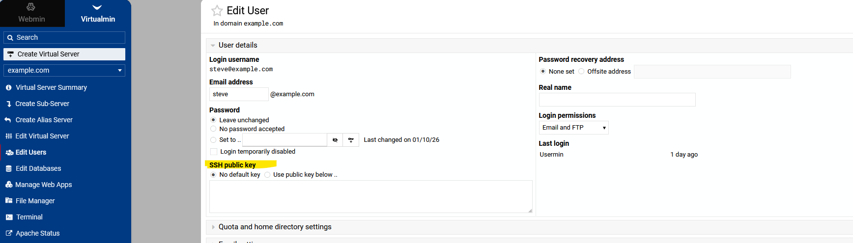

You don’t see this?
All of your domain owner users can have the same ssh public key(s) in their authorize_keys; the file that’s checked depends on the username you’re logging in as. So, when you ssh virtualmin@virtualmin.com ssh checks /home/virtualmin/.ssh/authorized_keys for your public key…if it’s there and you have the private key, it lets you in as that user.
That wouldn’t be safe. The key pair has to be generated on your own machine, and the private key should never leave that system. Only public keys go on your servers.
But, there is a form for uploading a public key for the domain which puts it in authorized_keys for that user.
Actually not. I have two users for the domain, one is marked as owner, the other is an user I added separately. The “owner”, for whom I wanted to add a ssh key, doesn’t have that window. It only shows email options, login permissions and last login.
The other has indeed the form to add a ssh key.
Ah, that’s why. I didn’t know that. So basically I just copy the public key into the owner’s .ssh/authorized_keys file? Can it cause problems if I add an individual key for that user?
