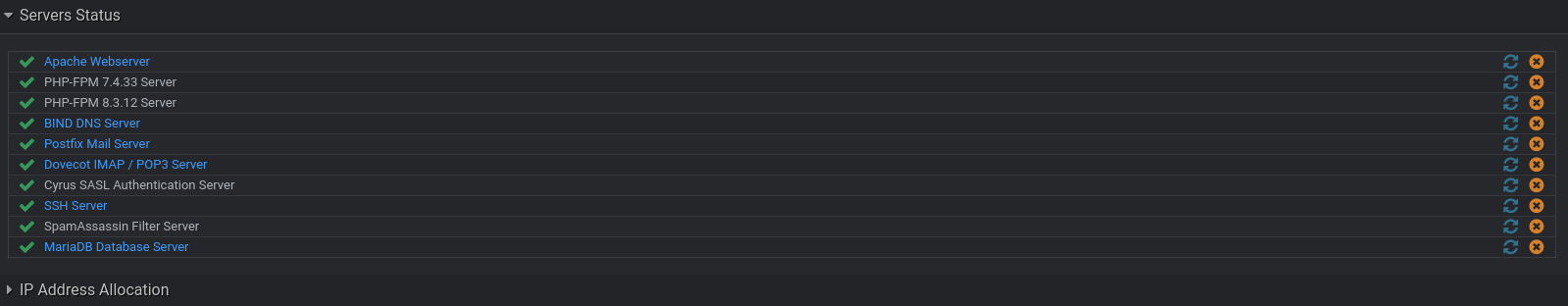

I saw different config of the server status (like on the picture)
I would like to create custom “Server Status” to display my multiple Php-FPM, but impossible to find how to add that.
Thanks for your help

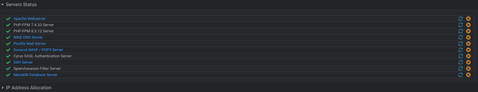

you mean like this ?
if so this was done by virtualmin automatically, as a test add the fpm servers to a system monitor
webmin->tools->system and server status
and activate it (there is no need to display it on the screen yet) and check back a bit later to see if the servers are being monitored and what their status is.
to add php-fpm to system monitors create a bootup action and use the dropdown to select the correct service and rename it, by default the name is bootup action
then you should see something like this
if this shows the status correctly I’m not sure why they are not displaying in the stock ‘servers status’ accordion
