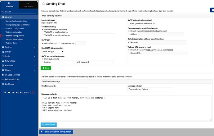

Most root-level notifications are configured in Webmin->Webmin->Webmin Configuration->Sending Email

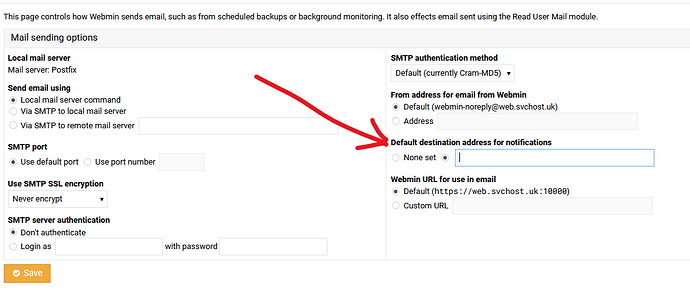

Webmin --> Webmin Configuration --> Sending email
You can configure one email address for all notifications to be sent to, shown below. Each notification target email can be overridden locally for each notification, if needed, so I highly recommend setting this up.
I should maybe also note that Webmin has its own built-in scheduled jobs service that handle most scheduled jobs for Virtualmin and Webmin including Virtualmin backups, and it will notify you of things happening via scheduled jobs, if it’s configured to do so.
