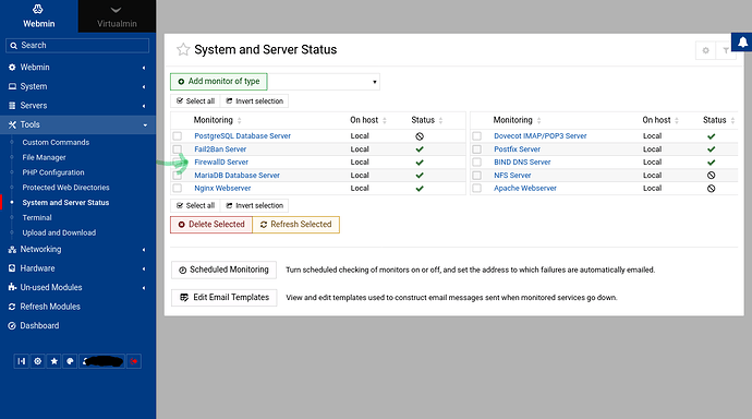

I set up firewalld and fail2ban as monitored services in Webmin → Tools → System and Server Status:
Is there a setting to show the status of these on the main Virtualmin dashboard?

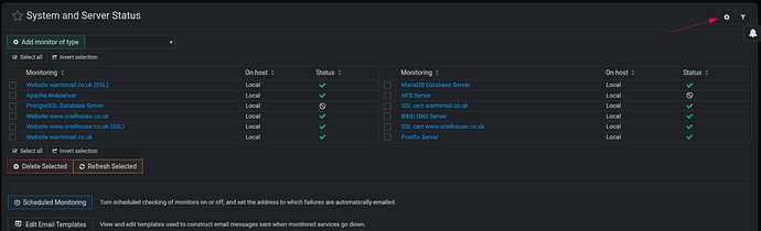

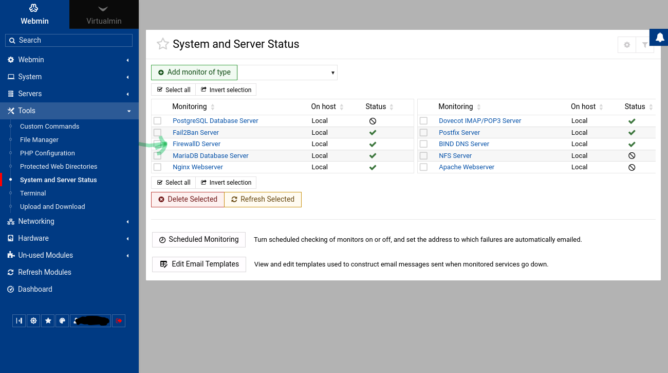

click the cog arrowed in the image
then make sure the options are set like in the screen shot

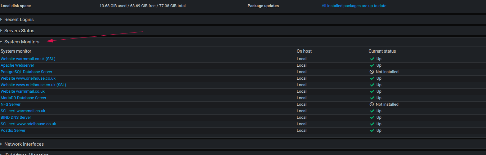

wait for about 5 minutes then you should see this on your dashboard

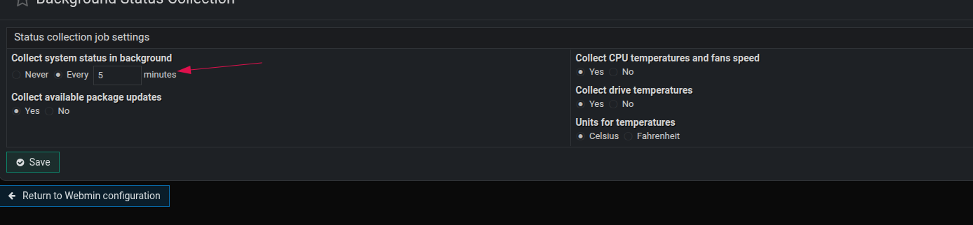

if you don’t see this appear the goto webmin->webmin configuration->Background Status Collection and toggle the arrowed setting to never back to 5 mins
then wait another 5 minutes
Thank you @jimr1 :grinning_face: It’s showing up now in that new System Monitors group.

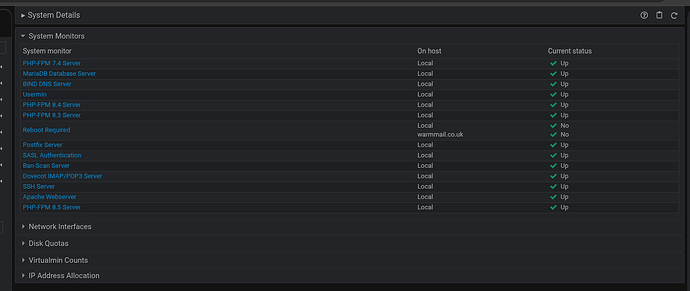

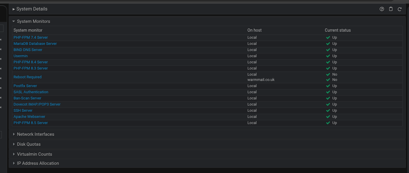

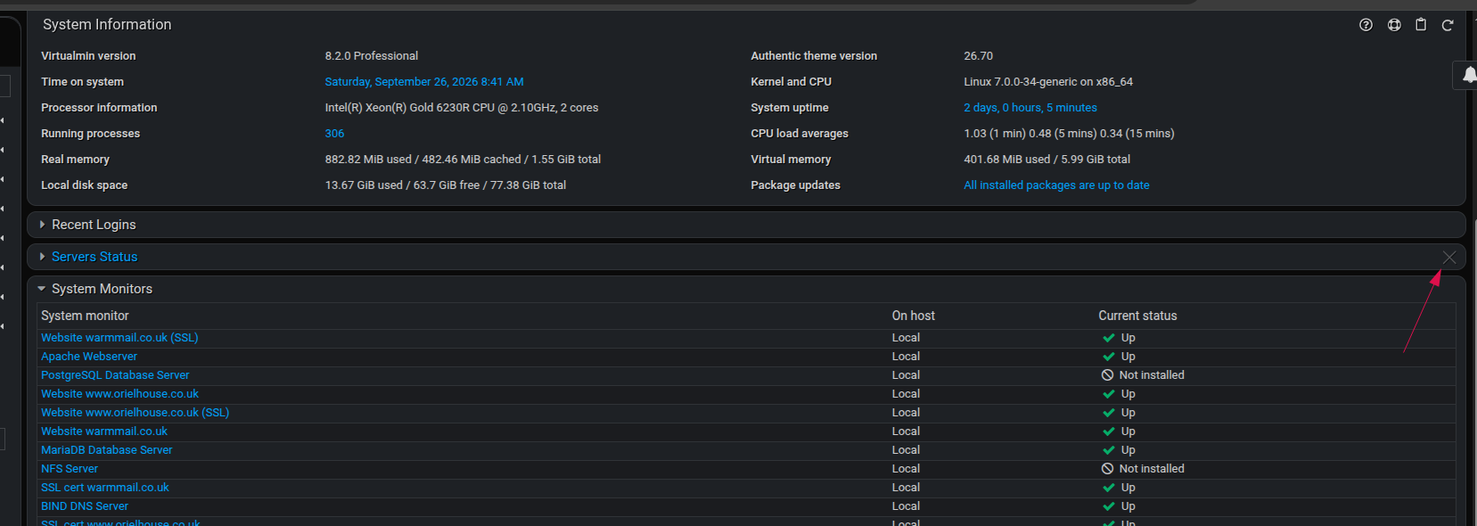

I don’t use the servers status module at I tend to remove it from the dashboard and use the system monitors module as in some cases it’s more powerful so on my production server the dashboard looks like this
Thanks. How to do that? And is it possible to also change the side-bar to pull that new section instead too?
hover on the item you want to remove and click the arrowed X

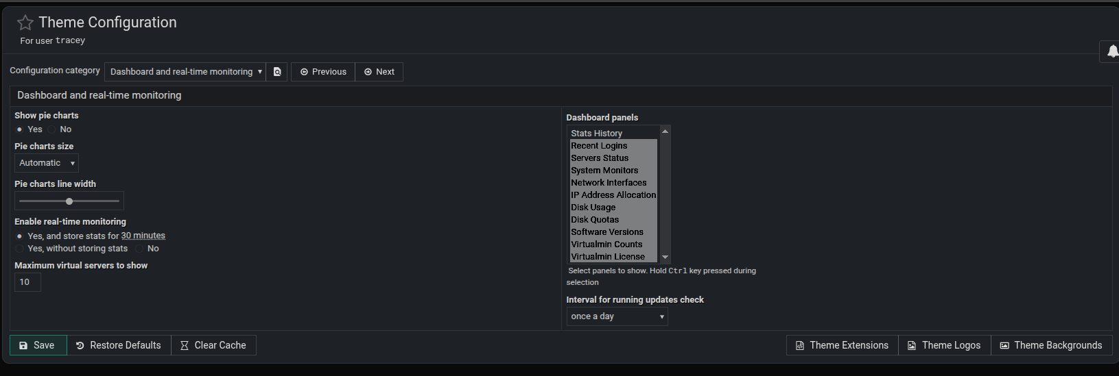

or goto Theme Configuration ->Dashboard and real-time monitoring and choose which items you want displayed on the dashboard

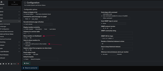

Sorry for the late reply. This is controlled by “Tools ⇾ System and Server Status” module’s config using “Show monitors on Dashboard” option.

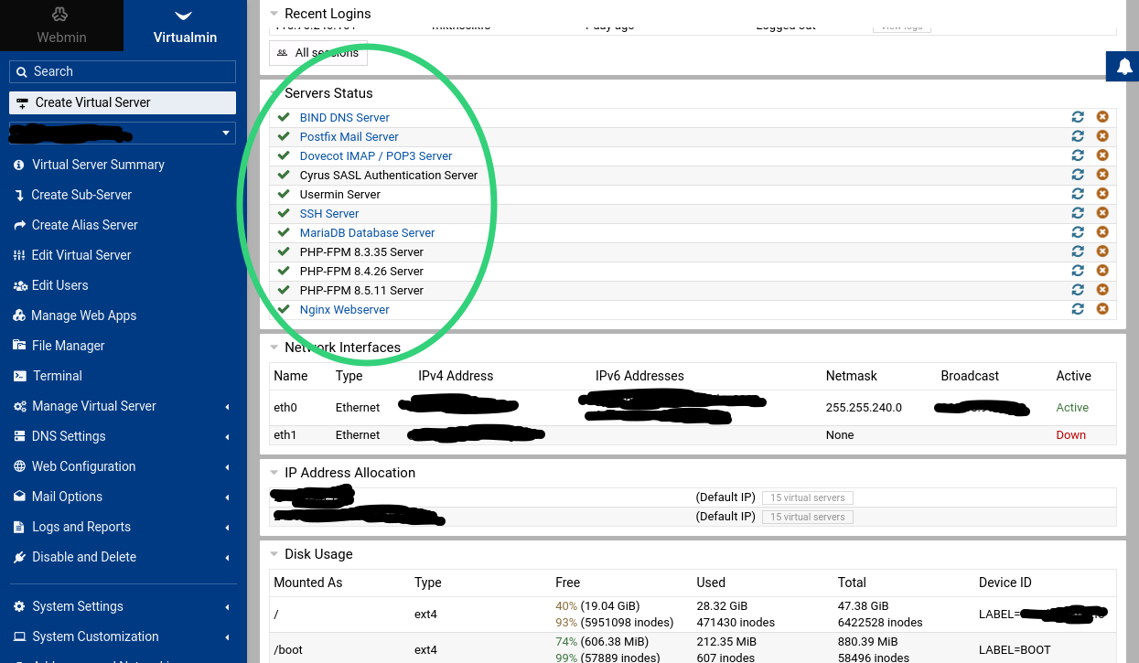

I have that setting switched on with ‘anyone with access can view’ set, however I do not see the system monitors in the side slider should the monitor setting be root only ?
Thanks for that. I have “Tools ⇾ System and Server Status” module’s config using “Show monitors on Dashboard” option too, but it doesn’t show up on the side. Just ‘Servers Status’ as pictured above.
Maybe @Ilia can answer as it also doesn’t work for me
