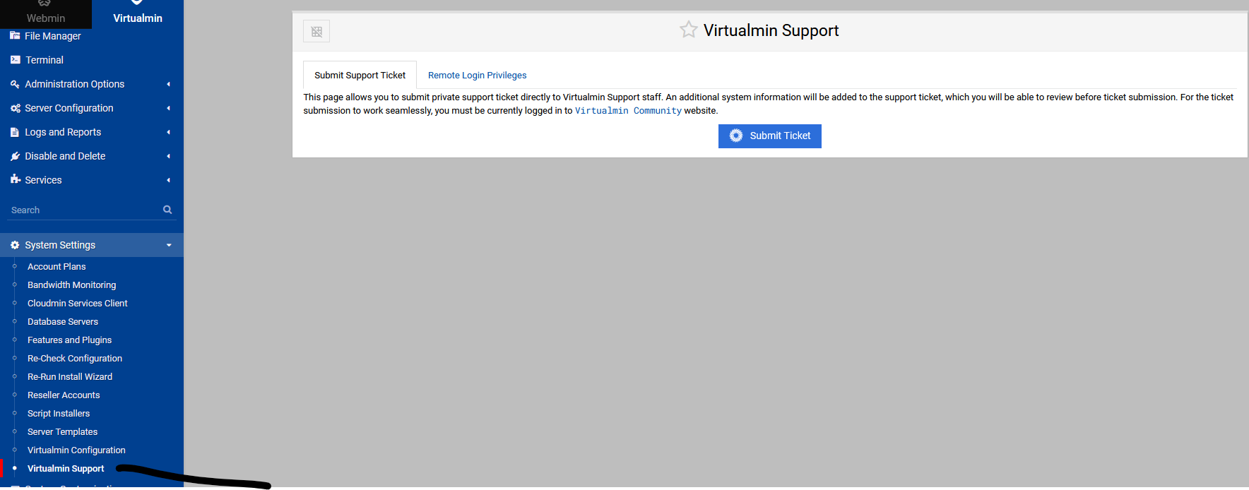

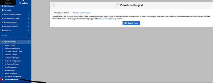

Is there a way to open a ticket, assist. staff or closer? I am in troubles with the quota problem.
Buy a Pro license to match your server and then you can submit a ticket I believe. I do not know what they will cover for that as I am on the free version.
https://www.virtualmin.com/shop/
I already got the pro license. But then, I’ve seen that the assistance offered is here. I guess…
it says private ticket support

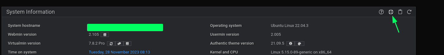

click the arrowed link in the screen shot
And here
Thank you all. Submitted a ticket. Really thank you for advise.
