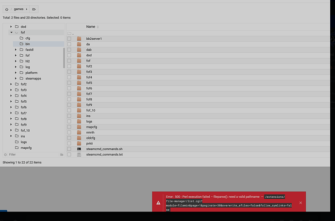

An Extra Admin is having problems accessing some directories the error is in the screen shot
any ideas ?

Yes, this is a real bug!
I will look into the best solution and let you know as soon as possible. It’s quite complex if we want to maintain speed with very large directories.

Just a thought, that directory is mostly symlinks would that make a difference as the error shows
follow_symlinks=false
maybe I could test it with follow_symlinks=true if so how do I set that up ?

Thanks! The issue was fixed now.
You can apply the patch below to make it work:
webmin patch https://github.com/webmin/authentic-theme/commit/02264ad
Original error:
Error: 500 - Perl execution failed - fileparse(): need a valid pathname —
/extensions/file-manager/list.cgi?module=filemin&page=1&paginate=30&overwrite_efiles=false&follow_symlinks=false
