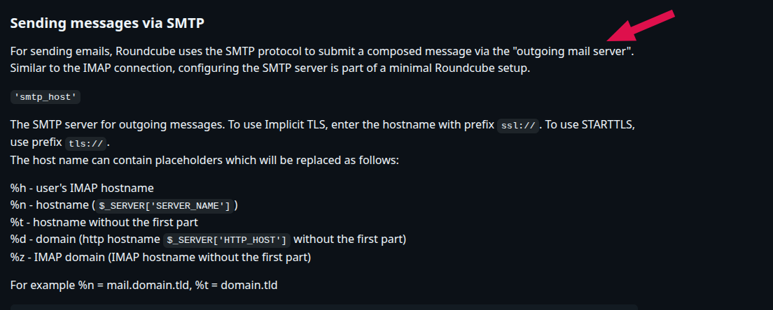

from roundcube’s documentation
the arrowed part of the document indicates that roundcube sends mail through postfix & not by another means, unless I read it wrong !
yes, but it remains a PHP app (although much of it is PERL based) which does mean it is open to just as many open doors as WordPress or any other PHP app.
