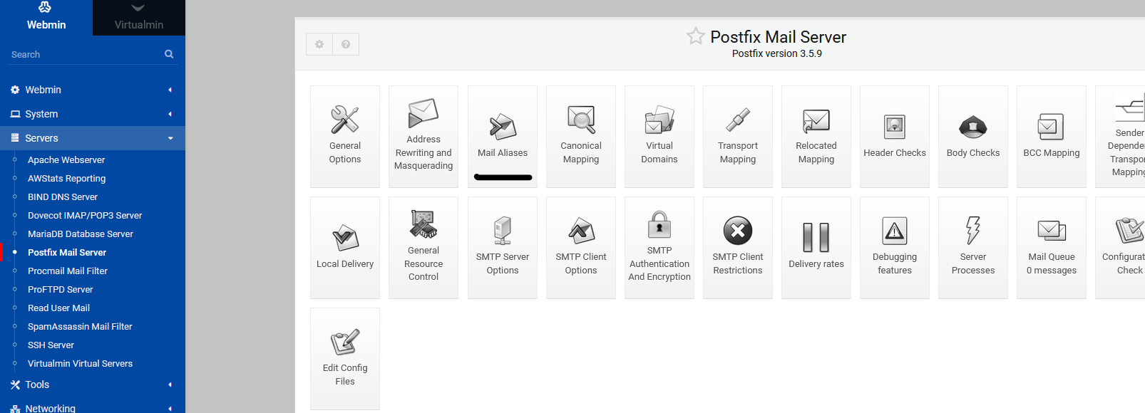

Does the forward area look ok?
Does the mail alias area in postfix look ok. it should have the entries created by virtualmin
