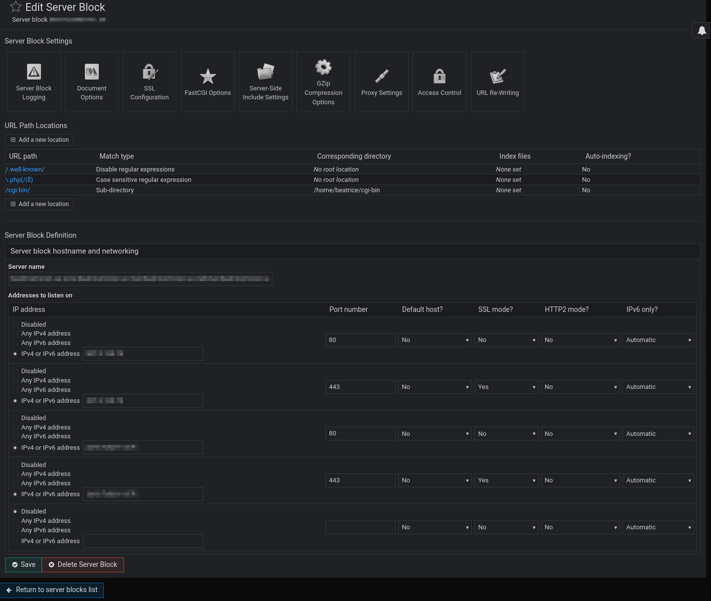

I made changes to the server block of a virtual server using Virtualmin > Web Configuration > Configure Nginx Website.
Goal was to enable ACME challenge for IPv6 so I had to add those blocks.
Saving worked, and the nginx configs were updated accordingly.
However this did not reload nginx, and I can not find a suitable button for it on the page where the config is saved, or a prompt that this should be needed.
The expectation would really be that after a server block is changed and saved, that nginx reload automatically.
I reloaded manually and then the ACME challenge worked as expected.
Am I missing something and doing this the wrong way, or is it a user experience that can be improved?
If it is the latter, I would almost like to argue that it could be a bug?

I don’t use dark mode so I don’t know if that’s a problem or if the new ā€˜easy on the eyes’ theme just makes it impossible to see. On my screen it is a light grey color. It looks darker on the screen shot because it darkens on mouse hover.
The button exists when editing from Webmin, but not from Virtualmin.
And I think expectation would be that edits from Virtualmin should reload nginx automatically if needed to apply the new saved settings.
It is in Virtualmin on the Apache configuration. So, I’d say this is an inconsistency between the two.
