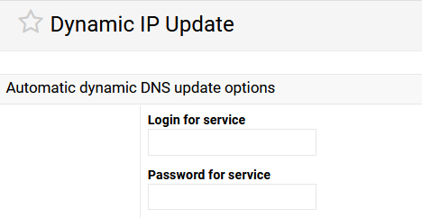

I am also not clear as to the use of some of these
If I select Dynamic update enabled (No) I would expect that the tool is disabled?
What does selecting Don’t update any service do?
Isn’t that the same as the first option or are other things happening?
Wouldn’t it also make sense to make these variables available for scripting in case they were useful?
My service requires a password which I just add in the script but it feels strange to me, that the tool provides the option to use this but it only applies to dynDNS?

You don’t need to run it from inside of your custom script, it will be handled by Virtualmin automatically.
