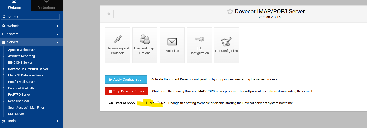

Usually the module will give a hint or show what configuration it is expecting. Can you screenshot what you see when you click on the module?
Is it configured to start at boot?

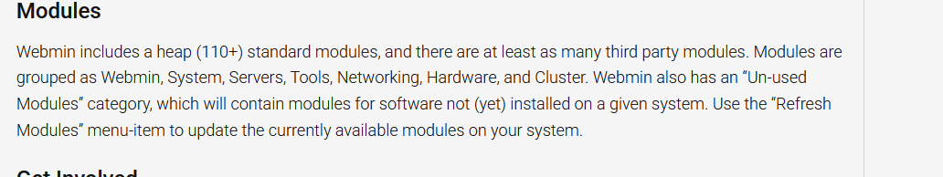

Try the refresh modules.

The problem was… or at least the fix. Was that I was only using Webmin. When you add Virtualmin it works as intended, and that is what I wanted anyway.
Did you follow this guide?
