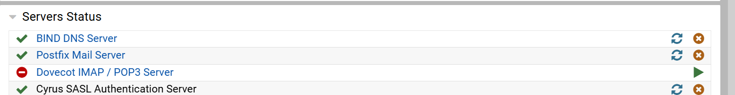

Dovecot status shows not running on the dashboard in Debian 12
Webmin version 2.610
Usermin version 2.510
Virtualmin version 7.50.2 GPL
Theme version 26.20
Nginx version 1.22.1
@Ilia this is also a problem for existing VS?
on a Grade A system
it refuses to restart (even following a reboot) I dare not touch all the other VMs that are now calling for a reboot

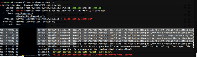

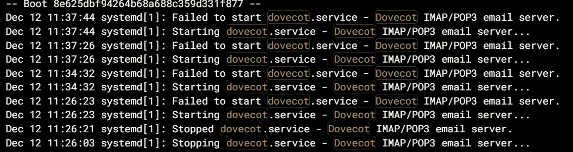

This is a different issue. Start by checking the actual Dovecot status in the “Bootup and Shutdown” module.
:face_with_raised_eyebrow:
Do you know how to check the service status using the systemctl command?
i think so :wink: but not sure that gets me anywhere nearer - sorry for the delay in replying but been fighting fires :firefighter: on another VM :collision:

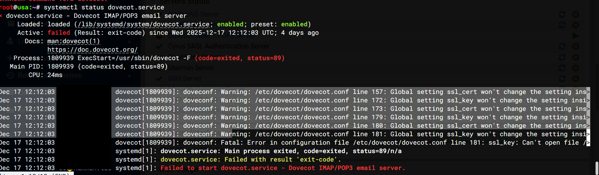

I have looked into dovecot.conf and frankly it looks a bit of a mess - it has never been edited at this end - I do not understand why the brackets do not match up for each local_name
I have edited it here to keep the domains anonymous:

  ssl_key = </etc/ssl/virtualmin/17585415762045681/ssl.key
  ssl_cert = </etc/ssl/virtualmin/17585415762045681/ssl.combined
local_name *.domain2.com {
local_name domain2.net {
  ssl_cert = </etc/ssl/virtualmin/17585418882048893/ssl.combined
  ssl_key = </etc/ssl/virtualmin/17585418882048893/ssl.key
local_name *.domain2.net {
local_name domain1.bond {
  ssl_cert = </etc/ssl/virtualmin/1758095965786769/ssl.combined
  ssl_key = </etc/ssl/virtualmin/1758095965786769/ssl.key
local_name *.domain1.bond {
Well, this is an old bug that was fixed a while ago. For now, you need to fix the Dovecot config manually.
The issue was fixed, and it won’t happen anymore if you’re using the latest 7.50.2+ version of Virtualmin.
do not understand why as it is a pretty recent VM (certainly 2025)
I assume that by “manually” you mean for me to edit the dovecot.cnf and place brackets {} around each local_name group, save and restart dovecot.
or
perhaps an easier way would be to delete the dovecot.cnf restart and then renew each domain’s certificate.
It’s the end of 2025, and this bug was fixed not too long ago.
Don’t delete the whole file, just remove all the local_name configs. Then click the “Copy SSL Certificate to Services” button on the “Manage Virtual Server ⇾ Setup SSL Certificate” page, and it will work—no need to re-request all certs.
@Ilia thank you :+1:
it is all working again now - have a good holiday season :christmas_tree: :wrapped_gift: :champagne:
Glad to hear that! Have a great holidays, too!
