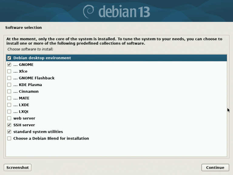

This graphic is one of the last things you see before Debian gets to work building the base OS on the bare metal.
(NOTE: the options for Debian desktop environment and ...GNOME are NOT! checked by default, but the place I stole this graphic from had them checked. :wink: )
I’ve been struggling for a while now (mostly based on my own bad decisions in the distant past) to get a old set of sites and databases to migrate to new metal, and the Virtualmin recommendation is to install a minimal OS prior to Virtualmin getting on top of that pony. Debian 13 only has the SSH server and standard system utilities checked by default, but that is SOOOOOOOO minimal that we even have to install the curl program to install the Virtualmin system.
I’m so sick of playing Guess-&-Test (aka: F.A.F.O.), yet think that Choose a Debian Blend for Installation would be a good idea.
Does anybody really know for sure what checkboxes to check & uncheck?
Tonight I felt like throwing plates at the walls after finding a brand new way to fail. I’d like to leave the Upside Down now.

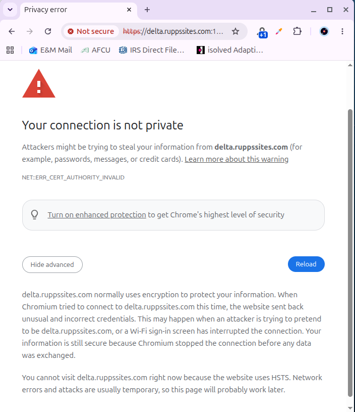

This is my new metal’s Virtualmin page after a reboot because I couldn’t get a POSTFIX error message to go away that was a latent problem that came from a virtual server restore. :expressionless_face: :expressionless_face: :expressionless_face: :expressionless_face: :expressionless_face: :expressionless_face: :expressionless_face: :expressionless_face:
That error has nothing to do with Postfix.
That error means Virtualmin couldn’t get a certificate from Let’s Encrypt.
Your Debian installation also has nothing to do with the problem. A minimal installation (with ssh and either curl or wget) is all the Virtualmin installer needs (actually it doesn’t even need curl or wget, as it’ll install one if they’re both missing, but the easiest way to get the install script onto your server is with curl or wget, so it’s easiest to install one of them).
You’re making this into a big mystery involving everything you ever did on the server. It’s not a big mystery, it is one specific problem, with one specific solution.
So, please simplify and focus on the actual problem, not all the perfectly normal steps of installing your OS and Virtualmin; those things are not related to your problem. No amount of reinstalling will fix this problem. (If there’s a problem with Postfix, we can discuss it in another topic.)
What happens when you try to log into Virtualmin? (Port 10000 on your system.)
If that works, what happens when you try to get a certificate for that problem website? Read the actual error when Let’s Encrypt tries to validate domain ownership. It’ll be one of maybe three things: DNS, something sucking up requests to .well-known, or web server misconfiguration is causing the wrong site to be served when Let’s Encrypt tries to reach your server.
The actual error message will help determine which of those problems it is.

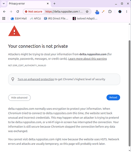

If you look carefully at the supplied screenshot the url ends in ā€˜:1’ as this is a reduced screen shot you could assume perhaps the OP is showing the connection to port 10000.
Ah, you’re right. I can’t see well enough to make that out without zooming in.
So, that just means the system hostname didn’t resolve during installation (so, the problem is DNS, one of the three problems that can cause Let’s Encrypt to fail to validate).
No big deal. Use a browser that let’s you log in to a system with a self-signed cert. I’m sure you can turn off whatever ā€œfeatureā€ is preventing it in Chrome, but if not, use Firefox just until you’ve issued a cert.
After a quick check on the domain names name servers it would appear that the OP is using cloudflare to handle dns. As I have never used cloudflare, I’m not sure if there some hoops to jump through in order for lets encrypt to work correctly, I seem to remember some threads about this some time ago
As a quick workaround, you can skip this screen by typing thisisnotsafe when it appears (not in any specific text box — just keep typing until it goes away).
It also looks like you’ve used this domain before in the same browser, and it’s on the HSTS list. Until you get a proper SSL certificate, you can access Webmin from another subdomain on the same system or use the IP address directly.
You could also try another browser or open an incognito tab to avoid HSTS preload on your domain. That way, the buttons at the end of the warning appear, and you can move to the login page with a click instead of typing the thisisunsafe phrase.
Lastly, the easiest fix, though, is to make sure delta.rupp.....com has a DNS record pointing to your new system’s IP before running Virtualmin install script.
Cloudflare for DNS has no effect.
But, Cloudflare proxying does prevent most types of validation. If using Cloudflare proxying, they’re the termination point for the TLS connection, and you have no control over it, so they handle the cert (but you still need a secure connection from them to your server, which can be their tunnel app or a TLS connection secured via Let’s Encrypt, but as noted, validation is tricky through the Cloudflare proxy).
