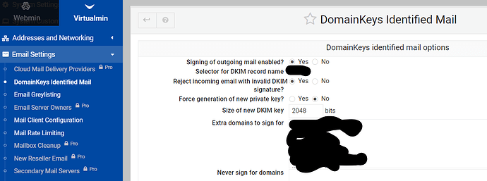

DKIM not working, sending with signature, or discarding

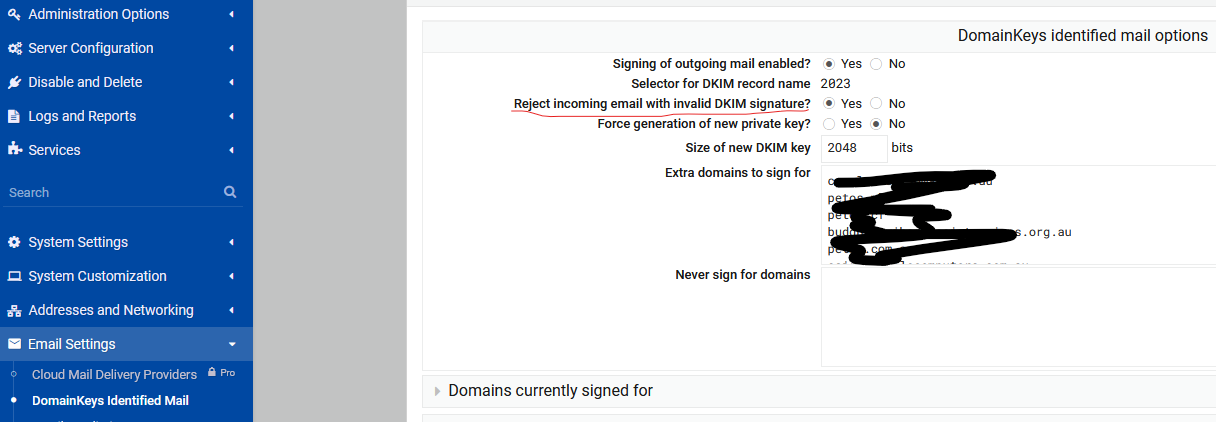

so this does nothing ?

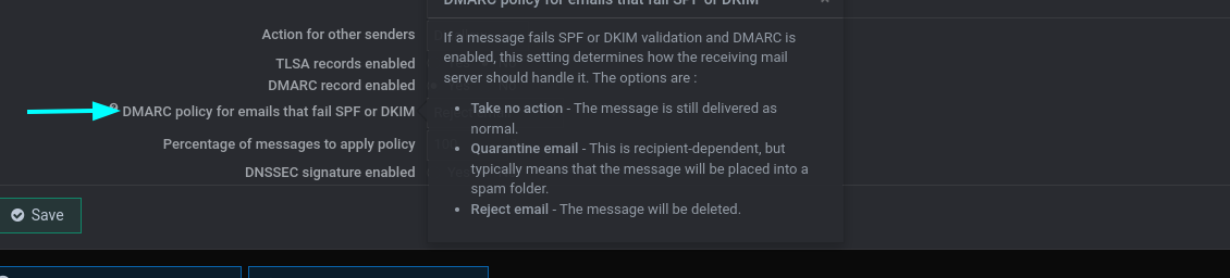

Of cause it does, check the explanation in the screenshot, its the policy for failed SPF or DKIM for the receiving mail server. Depending on the policy the recieving email server will do 1 of 3 things, Nothing, Quarantine or Reject.
https://www.cloudflare.com/learning/dns/dns-records/dns-dmarc-record/
It would appear that the OP is expecting the incoming email to be rejected through invalid DKIM records before it even gets to spamassassin which given the text of the help on this subject you would expect that to happen rather than falling through to spamassassin to process it
it perhaps should be made clear this doesn’t appear to be the case, or infact with that set to reject you should not see a DKIM_INVALID in the spam assassin header.
all I’m saying is it could be better worded perhaps
maybe this setting. This is not the posted issue.
not if the sending party has its DMARC record neutral (=take no action).
if we’re talking incoming, you’re the receiving party. you can only set DMARC policy for your own sending domains
@stefan1959 posts another option in virtualmin, that could work, not sure about it.
guys, i have it set correctly, its not rejecting the email:

DKIM does not not block spam, and again DMARC is the policy needs to be in place.

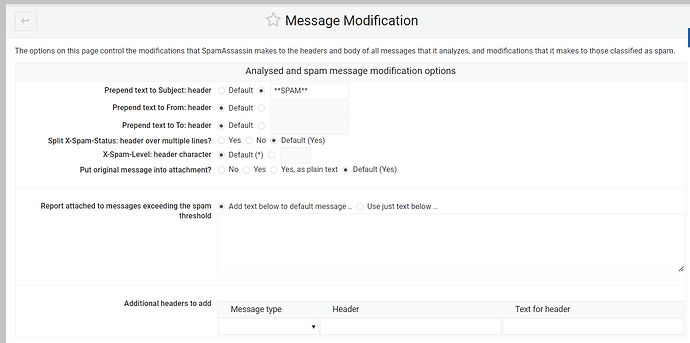

I never see SPAM in my spamassain from any email, ever! even though i set this to modify headers

why do i not see any *** SPAM*** header modification ?

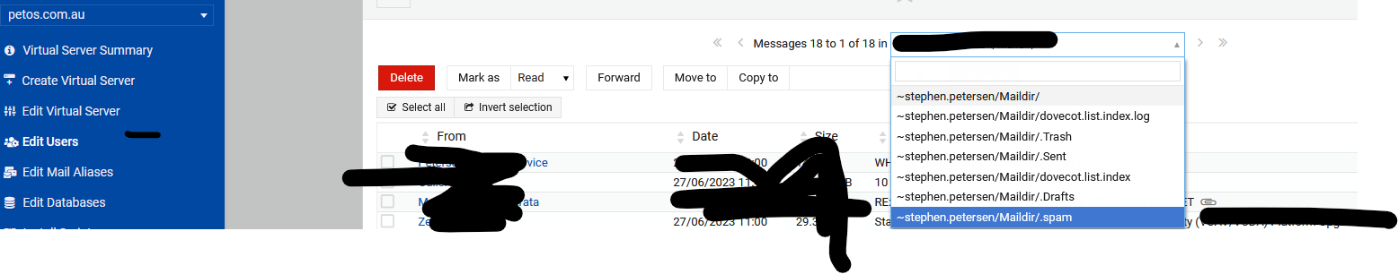

Spam with scores of over 5 are Moved to spam folder, it doesn’t go to inbox.
check in there for spam

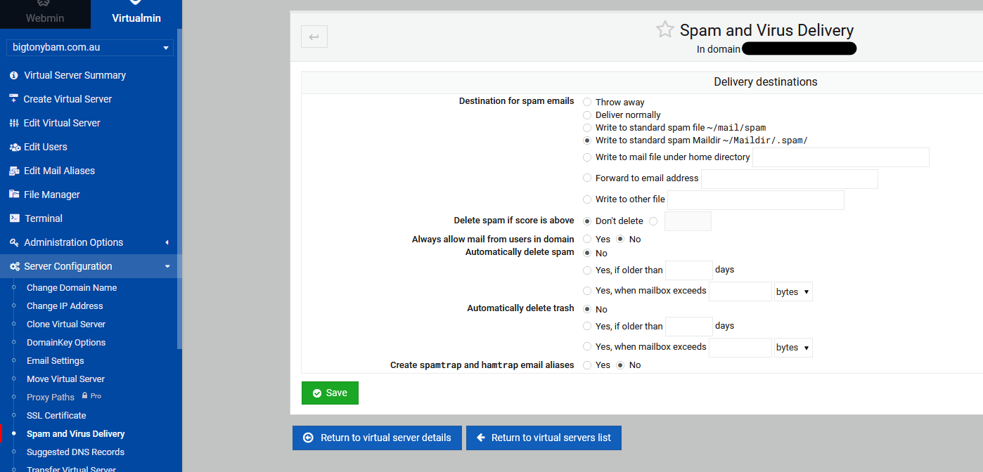

Each domain has its on config as long as enable on that domain

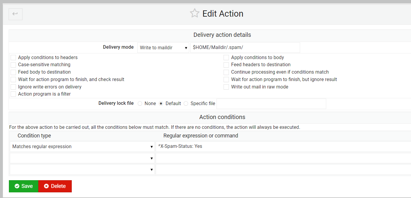

Yep, no spam emails in home/maildir/.spam (that is the problem)

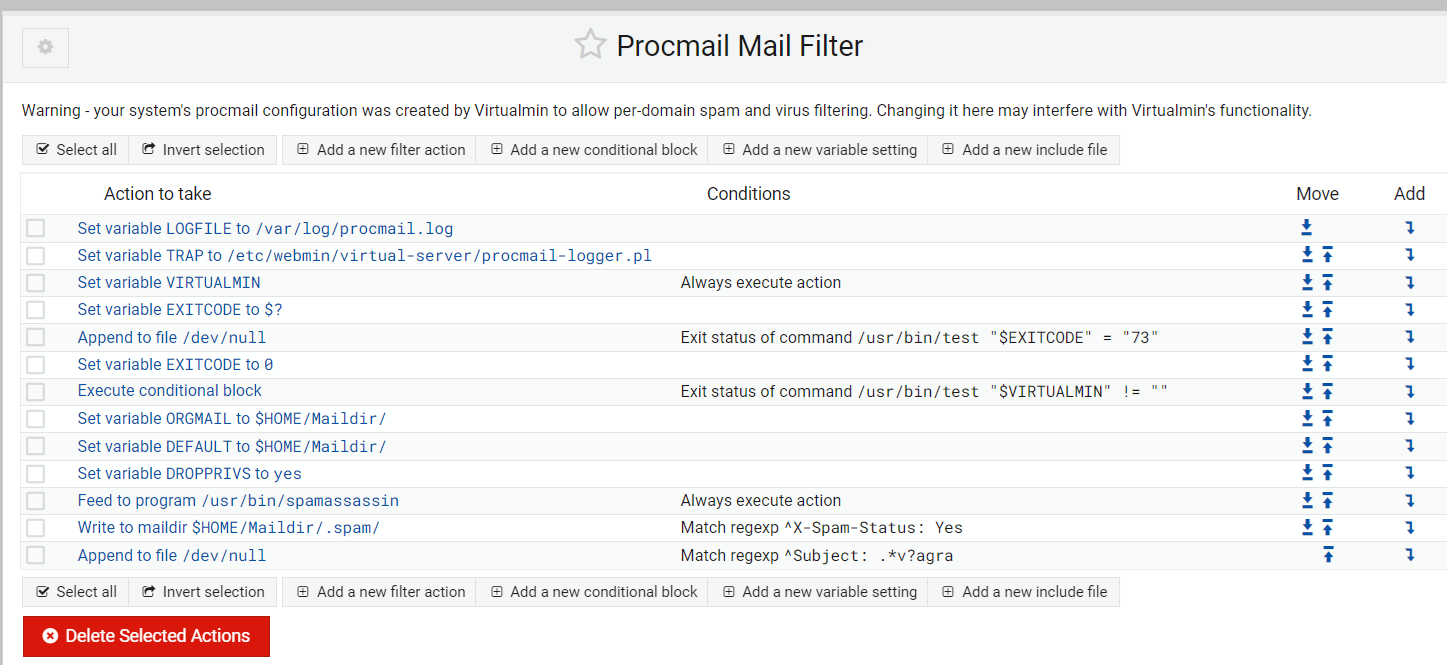

That is why I added the procmail delivery yesterday as below, to direct email from procmail to spamassassin
So we do not need a procmail rule like below to tell spamassassin where to place spam ?
Are any of the procmail rules below wrong ?
