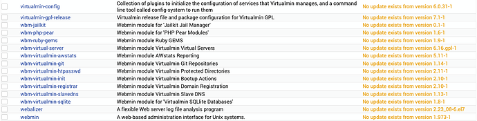

It’s an old server (still on CentOS 7.9) and it stopped showing me any available updates a while ago:
Screenshot 2024-12-26 at 22.00.45

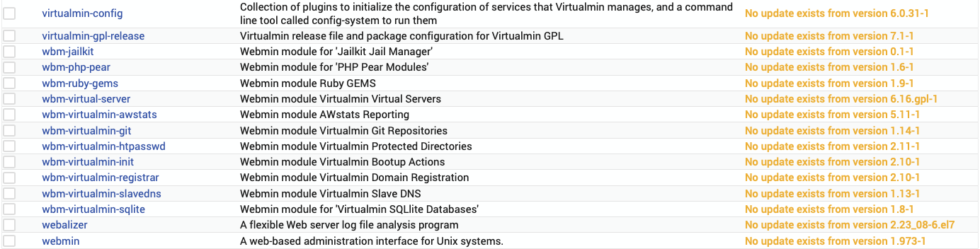

Am getting this Joe: Webmin > System > Software Package Updates > Installed
(Basically everything says no update exists)
Screenshot 2024-12-26 at 23.59.51
What happens when you do:
dnf update
Or:
yum update
It’d have to be yum for this server… but will that update PHP/MySQL etc? I don’t want those updated as some of the sites are reliant upon old versions : /
Then simply update the packages you wish, e.g.:
yum update webmin usermin wbm*
