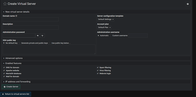

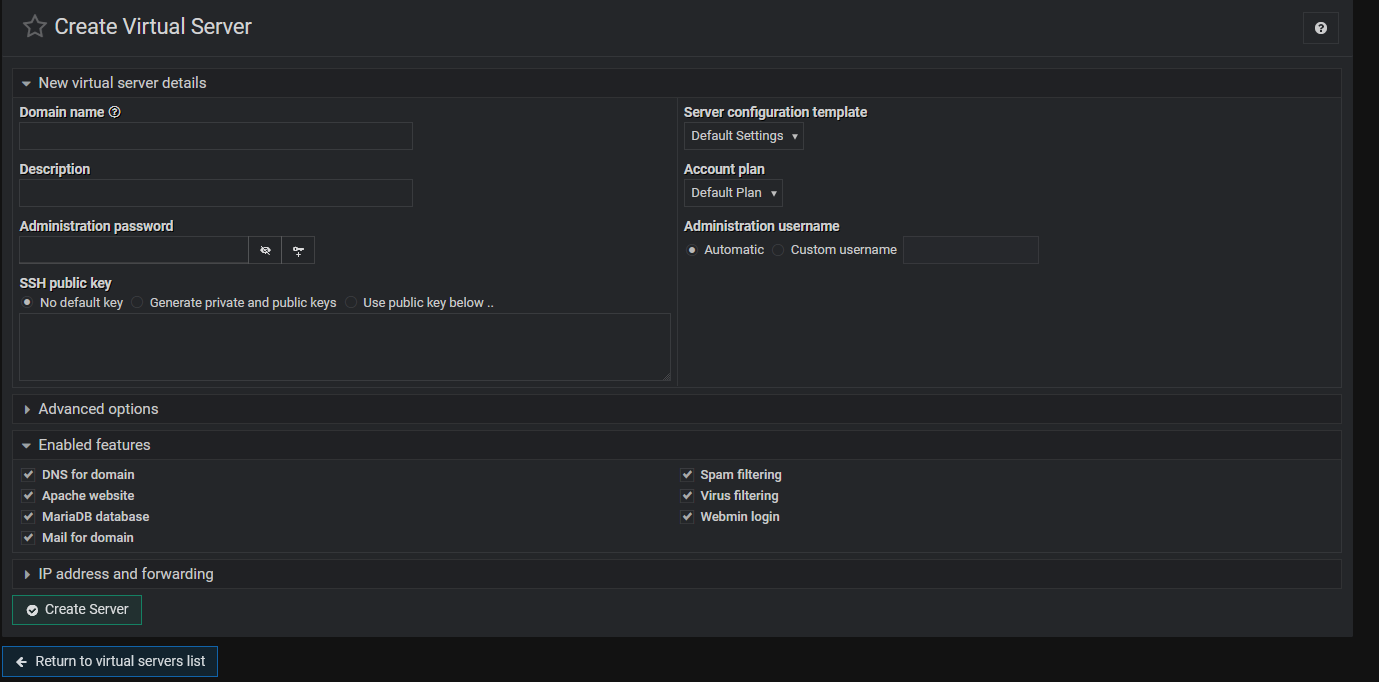

Can you show the form for creating a new domain, when “Create Virtual Server” is clicked, especially the “IP address and forwarding” section and its default settings?
I confirm I use default settings.
What I can see is the IP is added on VirtualHost instead of * , as all other domain has been setup with * this maybe create issue and I need after edit the VirtualHost replacing the shared IP showed in the screen with an * on port 80 and 443 so all other websites return to work after a downtime for invalid certificate.
