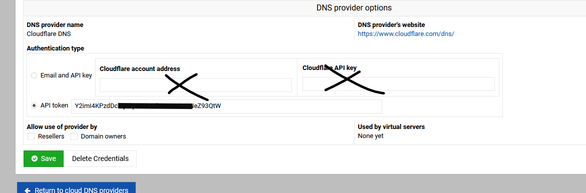

But it failed after input the cloudflare account & API token: Failed to save cloud DNS provider : Missing or invalid-looking hexidecimal API key

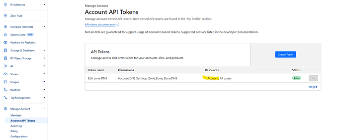

I test and worked, all I needed to do was add token, no cloundflare account details needed.
I use the API as you mentioned, it can be saved and passed.
But after that i choose it from the Virtual Server, it appear another Error:
Failed to save DNS options : Failed to update DNS host : Failed to setup new DNS zone : Adding new DNS zone hosted by Cloudflare DNS .. .. failed : No account found
I had a play, got it working with theses settings.

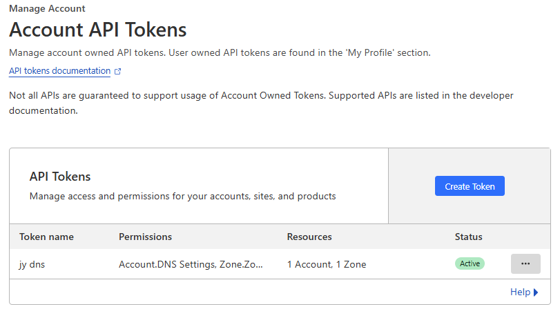

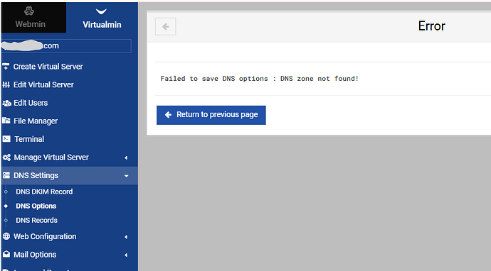

As my Cloudflare more than 1 domain, it is required only specific zone can be edit. So I created this Token and tried again, now the virtualmin return another error: Failed to save DNS options : DNS zone not found!
only difference I can see , you have it set to 1 zone, not all zones.
If I edit I see this
as other domains in my cloudflare account cannot be opened for editing in this server. I must specific the zone. So do you mean virtualmin cannot process my case at this moment?
Virtualmin will only manage domain’s that are on virtualmin as far as I see it.
