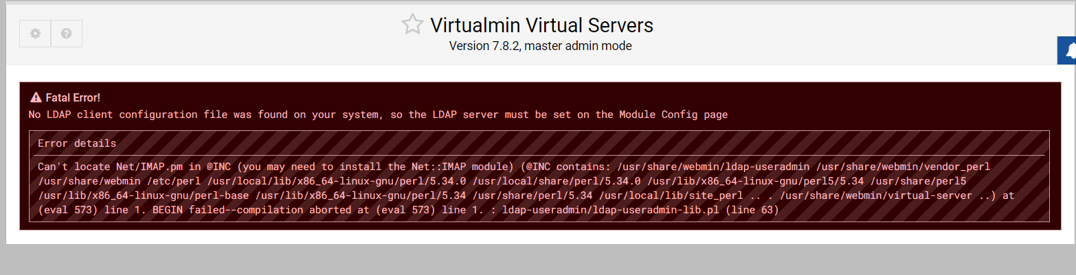

Actually its getting worse.
(this was Virtualmin -> List Virtual Servers)

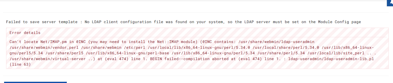

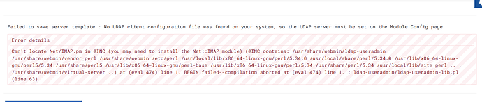

and
Everything now appears to be looking for an LDAP server and throwing an error (this was editing/creating a template)
