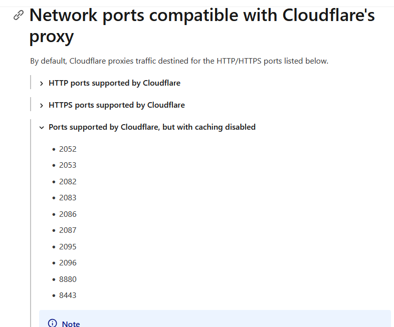

>  **Before I do that, I note Cloudflare has specific ports that are not proxied: "Network ports**
> **Learn which network ports Cloudflare proxies by default and how to enable Cloudflare's proxy for additional ports.**
> **Network ports compatible with Cloudflare's proxy**
> **By default, Cloudflare proxies traffic destined for the HTTP/HTTPS ports listed below.**
> **HTTP ports supported by Cloudflare**
> **HTTPS ports supported by Cloudflare**
> **Ports supported by Cloudflare, but with caching disabled**
> **    2052**
> **    2053**
> **    2082**
> **    2083**
> **    2086**
> **    2087**
> **    2095**
> **    2096**
> **    8880**
> **    8443**
> **Note**
> **Enterprise customers that want to enable caching on these ports can do so by creating a cache rule."**
> *The tunnel is already working correctly — those port restrictions only apply to Cloudflare's standard proxy (orange-clouded DNS records without a tunnel). With a Cloudflare Tunnel, cloudflared can connect to any port on your origin, which is exactly what we're doing with port 10000.*
