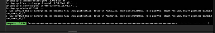

I’m trying to re-install Webmin but keep getting out of memory errors. Running Ubuntu 24.04.03 with 4GB of RAM on a virtual machine. I have other servers with less RAM that installed Webmin just fine.
The install eventually completes, but something goes wrong because then I cannot access Webmin in the browser. It logs me in, but never fully loads, and eventually the Webmin process is killed by the server because it runs out of memory.

I agree, unfortunately I had no choice. This problem started yesterday during a normal system update. Webmin was one of the items to get updated. During its setup, the out of memory errors started. I then tried the uninstall/re-install.
