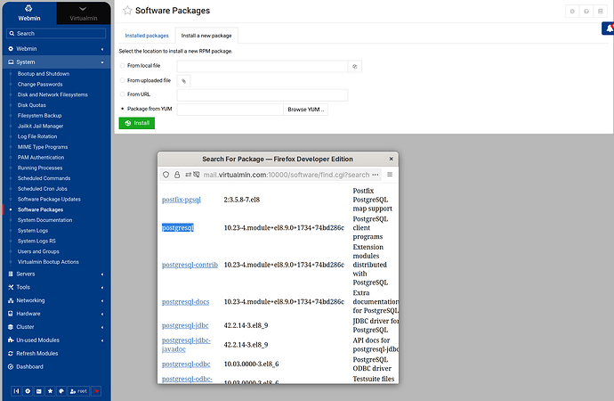

To install it, use your OS package manager. You haven’t told us your OS, so I can’t tell you the exact package names. But, you can search for the postgresql packages, either using the command line or in the Software Packages module. You certainly need the client and server packages, and you probably want the Perl DBD::Pg module (installed from your OS package manager, not from source from CPAN, never install from source when you can install a native package), as well, as it makes the Webmin module faster and more capable.

You probably want to browse to Webmin->Servers->PostgreSQL and make sure the server is found and operational and can be interacted with. Since it hasn’t been part of the standard install. You may need to click “Refresh Modules” if you don’t see PostgreSQL in the Servers menu, as it may be in Un-used Modules.
