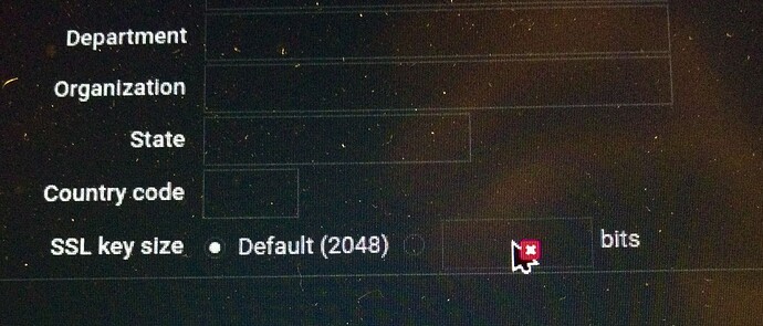

Trying for days to change my Letsencypt key from 2048 to 4096.
I tried change /etc/letsencrypt/cli.in with rsa_key_size = 4096.And renewing the keys. But that did not work. If I try to reissue the new key, I can not change the SSL key size (seems locked to 2048) .
Any suggestions how to do it?

This is what I see when I hover over the input field of the SSL size:

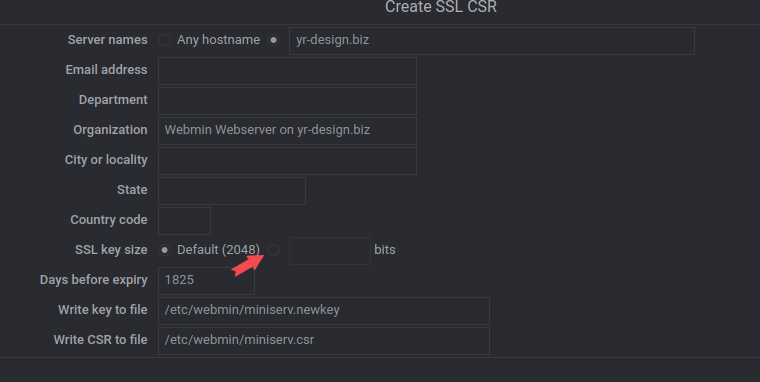

dunno what this is, but I guess if you selected the second radio button, after the text (2048), this should allow you to edit that field on whatever panel that is, I don’t recognise it as anything from the virtualmin project so it may be worth asking whoever maintains it
Under webmin you get the option to set key size. (clue in first post) I don’t see the other fields above it though in the first post.
EDIT: Those fields come from the ‘cert signing request’ screen, not Let’s Encrypt.

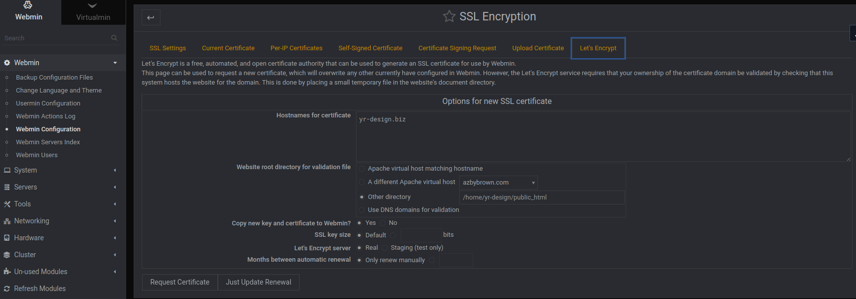

Thanks for the reply. The problem is that I tried it Webin/Webmin Config/, but could not do it. Same issue. Can not change the default. See screenshot below.
I clicked on the radio button and entered 4096. That’s as far as i got since I don’t want to actually change it at the moment. I have no commercial sites so I don’t want to add processing overhead.

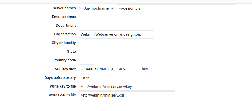

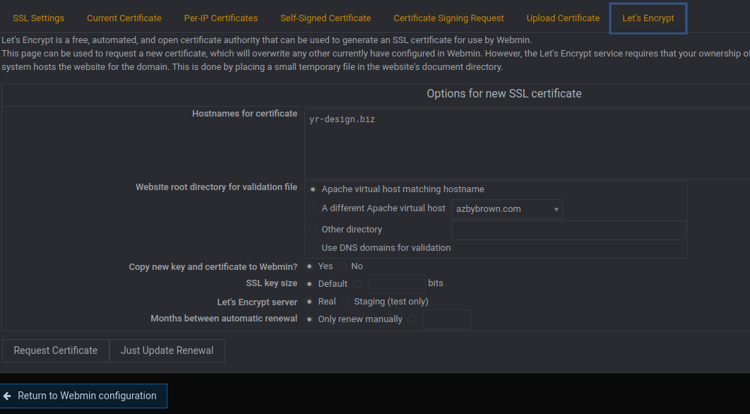

Thanks for the fast reply. My bad, I could not see the button in dark mode. Got it now!!
Seems to work!!
Dark mode:
Light mode:
