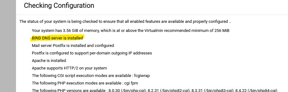

What it failed during install?(the virtuamin install I mean, you shouldn’t install Bind separately)
Run Recheck Config, any errors?
Oh shit, the detected external IPv[4|6] address isn’t anything familiar to me.

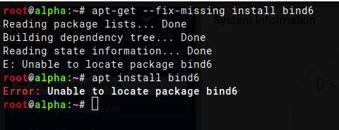

Bind9?
why trying Bind6?
When I first used the options in Virtualmin to enable BIND for that virtual server, it errored out and while following the error message trail, I saw that specific verion so tried doing it, and then after searching the error for what other people ran into.

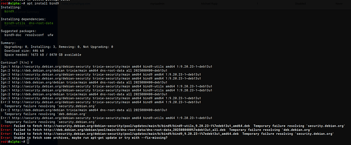

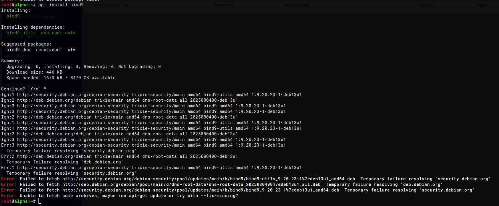

I definitely tried bind9 before the 6 got stuck into my failure spiral because here is the bind9 error. At some point I saw a thing about adding in other repositories, but they didn’t help either.
I just ran apt list --installed bind9 on my Debian 13
bind9/stable-security,now 1:9.20.23-1~deb13u1 amd64 [installed]
On mine it replies with nothing.

Well something is going on because in your screenshot it just errors trying to fetch from repo’s
Firewall? apparmor?
But you only have trouble with bind?

There’s never been a BIND 6. Three decades ago, they jumped from BIND 4 to BIND 8. They’re on BIND 9, now, and all of our supported distros use BIND 9.
Your failed installation of bind9 is due to name resolution failure. Your DNS servers weren’t working for that name at the time when you tried. Totally unrelated to Virtualmin. You need the DNS servers you’re using for resolution to work (this is not your DNS servers, this is usually the DNS servers of your hosting provider or some large free DNS resolver like Google’s 8.8.8.8 and 8.8.4.4 or Cloudflare’s 1.1.1.1 and 1.0.0.1, or whatever).
Sorry for blaming Virtualmin, but since this unhappy trail started after checking a box on a Virtualmin form for a virtual server, I didn’t know.
