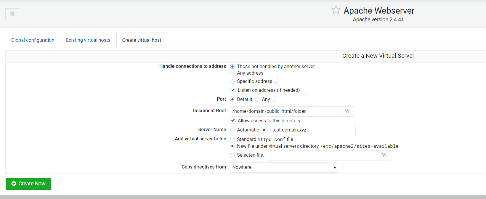

I think somewhere in Virtualmin this can be done (I just forget where for now) but this could also be done by symlink’ ing the “sub-server” to the actual subdirectory below home/domain.ckub or indeed anywhere.
Give this a try, Webmin->servers->apache
This worked for me credits to @jimr1

assume you want bulletins.urdu.rnn.live’s document root to be at ~/public_html/admin.urdu/public/bulletins. This method does work also along with the sub_domain option that you have with the ‘create server’ option you have in virtualmin, but as Joe says the sub_domain option is not open to all .
@evanv25 refers to another thread which explains fully how to do this if the sub_domain on virtualmin server creation does not exist see here

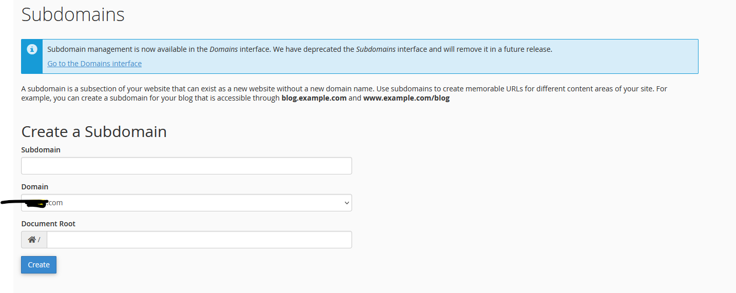

You have enabled the Subdomain account type in Virtualmin. It does literally what you’re asking for, including the ridiculous filesystem layout. The subdomain type in Virtualmin (deprecated years ago, because it’s ridiculous) came from the desire of users to migrate directly from cPanel, including so-called “subdomains” from cPanel.
I really hate the whole concept of “subdomains” as cooked up by the cPanel folks, so we got rid of it. The code lingers, and ends up turned on if you restore a backup that has subdomains. That seems to be what’s happened for you.
Again, I think “subdomains”, as cPanel imagined them, are ridiculous and have security implications nobody should be happy with, but, you seem hellbent to do it that way, so, go for it.

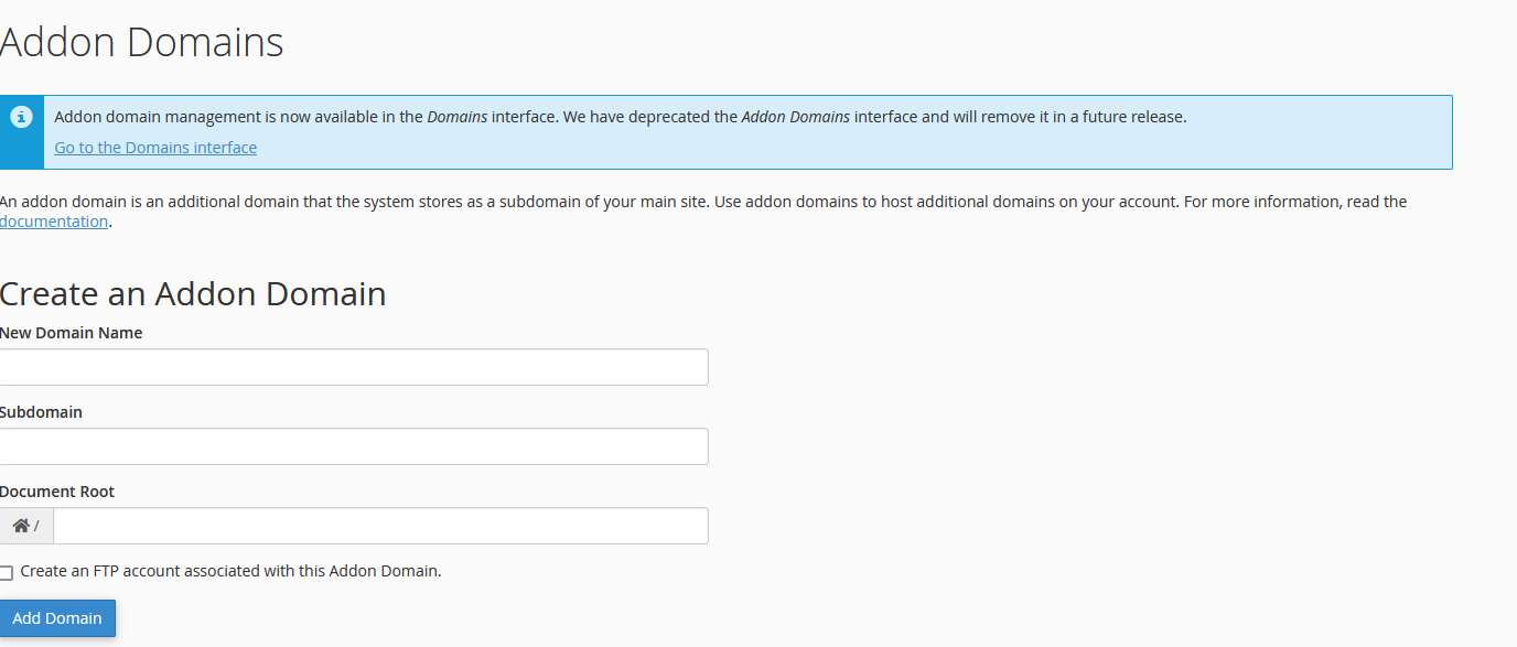

Don’t cpanel call it addon domains? subdomain is whatever.mydomain.com or is that what your talking about.
Holy crap! cPanel finally realized cPanel style “subdomains” were a mistake. Will wonders never cease?

  1. create each domain using the webmin apache module and writing the directives by hand
  2. create each domain using virtualmin then using the webmin apache module edit each domain directives to reflect the correct user and path (document root) and which other directives the OP sees fit to remove or edit.
